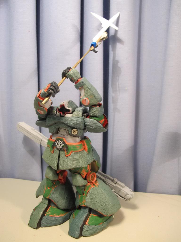

Hey there guys,
I was hoping someone could suggest a way to achieve this rough armour texture on this geara doga:
Thanks guys

Its called Zimmerit armour and the Germans used in the war as an anti magnetic mine coating.
To do it, add a coating of Milliput putty and texture it using something with a flat edge. Alternatively, Trumpeter has a tool that does it too.

use a soldering iron to melt the plastic

there's also a few companies that make zimmerit on plastic plate. Dragon had a German Tank Accessories set some years back that I got for the zimmerit.

apply thin coat of Tamiya grey putty and light brushing with "old" toothbrush...
you don't really want the zimmerit effect pronounced unless you are working in 1/35 or 1/48 scale~ :)

this texture is interesting I will call it contemporary zimmerit, will copy this for next years GBWC.
What I can tell you is how I made this and I imagine the process is similar. Just expoy putty (nice and thick for your pic) and a different pokey tool I used a no. 16 excel blade.
Sadly heat distorts plastic randomly and is near impossible to control the effect I would advise against this plus the fumes are toxic.
But!! it looks so sweet on zeonic MS's.........
