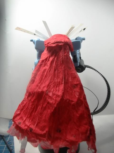

And this was the finished product
EDIT: Transferred the whole tutorial here for those interested
I plan to make this Slash Zaku Phantom into a Spawn looking mech. Itís a 1/144 scale, no grade model kit. It stands about 12cm tall.  The cape is really crucial if you would like to have that spawnish look.

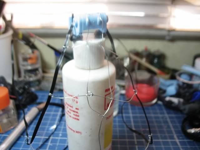

First, make the frame for the cape. Here I used a combination of twist ties and stripped ones. Anchor your frame to the desired position. Height is really crucial when making the cape.

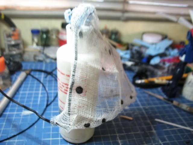

Measure the right size for the gauze. The gauze will reinforce the cape and make it really sturdy and make it movable without tearing up. Set the gauze using blu-tac.

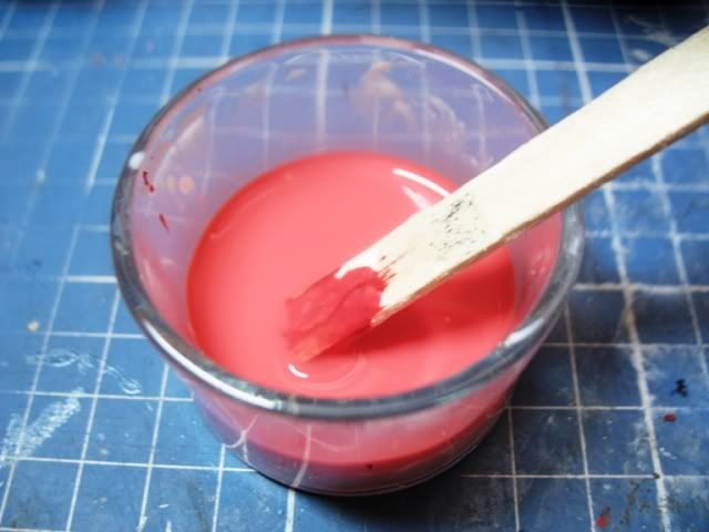

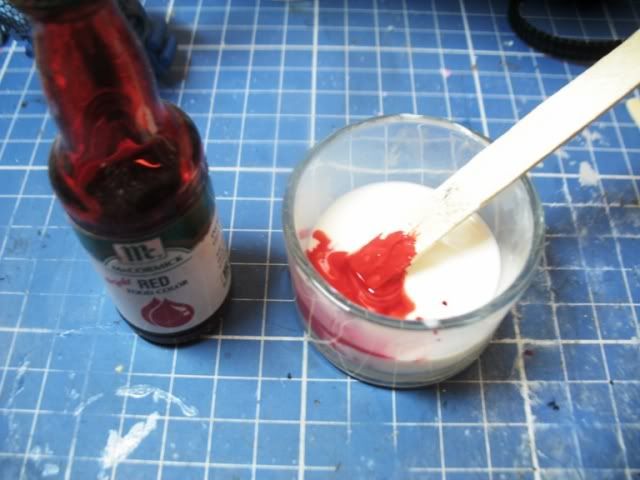

Now mix 50% PVA glue and 50% water. Here, I added red food color to the mixture so that the cape will already have a base color. Very handy step when you are making any paper machete project.

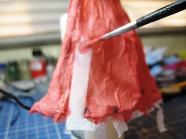

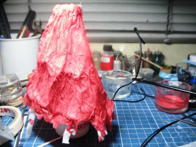

Cut small strips of tissue the same height as your cape and about one centimeter wide. Place the piece of tissue on top of the cape/gauze frame. Brush the colored PVA mixture on the piece of tissue making sure that the gauze will also be soaked with the glue mixture. Cover the entire area of the cape and also cover the inside part. Avoid using one big piece of tissue paper. This will not give you a good texture on the cape.
Two or three layers of tissue should be enough. Now let dry and color as needed.

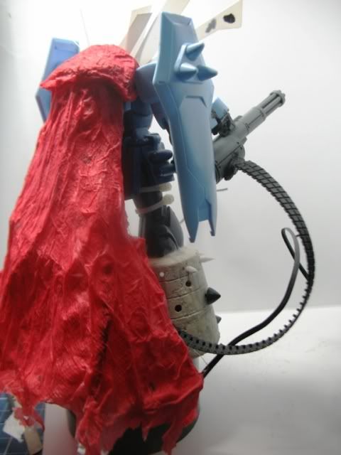

Here it is installed on the mech. Cut the excess as desired.
