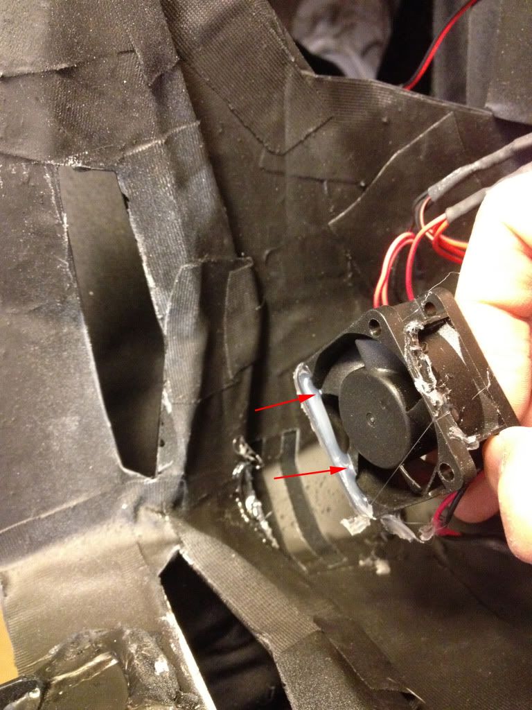

Hot Glue sucks:
Never said it before, so I'll say it here. I really dislike hot glue. Not a whole lot of positives, but I can name quite a few negatives....
- takes time for the glue gun to warm up
- glue gun is awkward to use in tight spaces
- glue sticks always run out. all the time.
- MESSY!
- those spiderweb-like strands with each use. And it's endless!! You just keep pulling and pulling
- not really a strong bond.
- dries cloudy
Obstacle: Here, I globbed some hot glue in the area where I was to place the fan. But, it rolled over into the fan blades!!!! UGH!!! Glued them down. I had to go back in, cutting and re-melting the hot glue to rip the  fan unit out. Some more cutting and sanding got the blades free. Hot glue sucks.

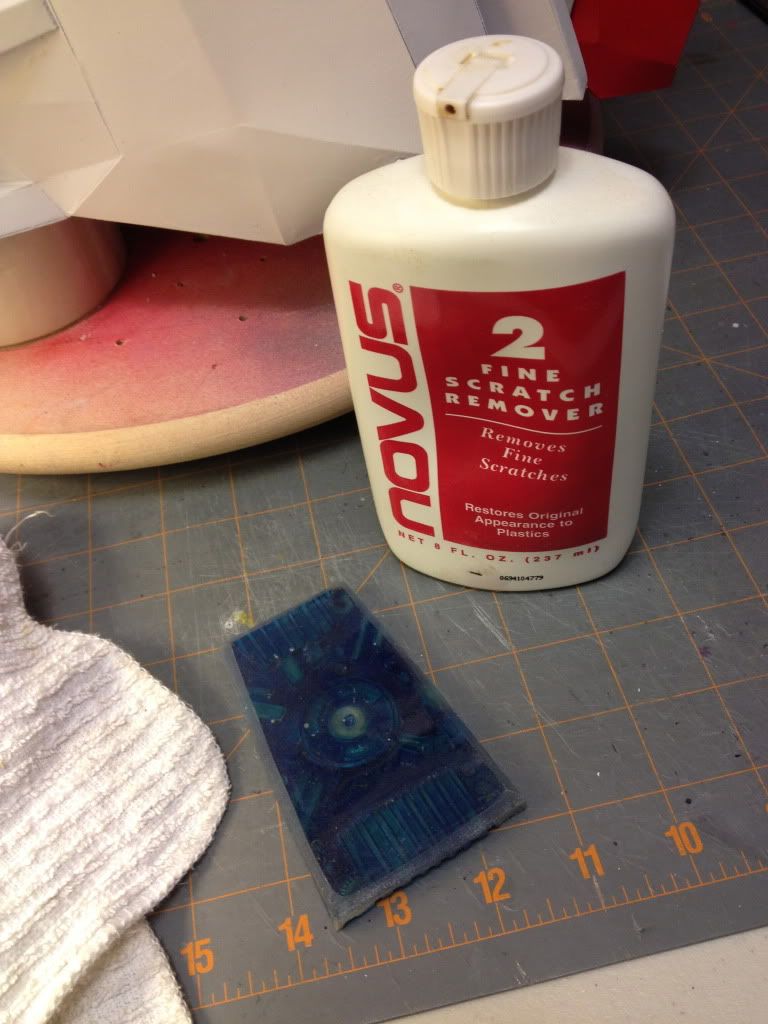

Polish:
The "camera lens" in the mohawk is a bit dull. So, I grabbed my bottle of 'fine scratch remover'. It was for polishing up tiny scratches on my rear plastic window on my convertible. Grabbed a towel and rubbed the face up with lots of elbow grease.

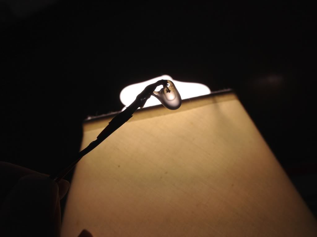

LED Experiment:
While I was wiring some of the LEDs, I noticed one of them had a bad flicker. So, I cut it out of the system. As decided to use it for experimenting. I wanted to see if I could diffuse the LED bulbs a bit. And I know hot glue dries cloudy. So, I put the two together....
I globbed some hot glue right ON the LED bulb. And let it dry. You can see in the pic... the LED bulb is completely "submerged" inside the wad of hot glue.
Test wired it to my battery... and voila! A nice diffused glow! Success. I'll do this to a few of the bulbs in the "camera lens"

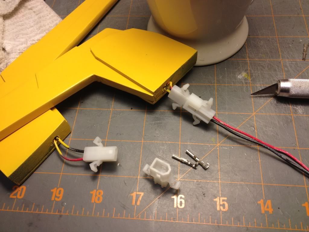

Wire connectors:
Bought some quick-release wire-to-wire connectors for some parts of the electrical work. The fins are separable, so these are needed. I'm not really liking these types. But I couldn't find any better alternative. These were pretty prices too. Don't like pricey.

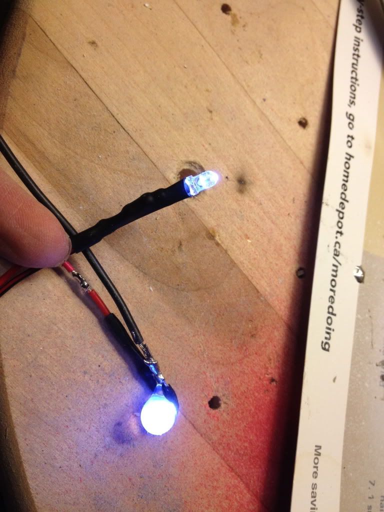

Lit Eyes:
The wiring for the eye LEDs are in place. All that's left to do here is paint the wires matte black and find a way to shield the bulbs so when they're lit, they won't cause a glare back at my eyes.
Had some leftover "turn signal amber" paint from my car models of the past that was the perfect shade I was looking for. Now, I had both yellow and amber paint. Tried them both, but found out the bluish tint of the LEDs made the yellow shine green. Whereas the amber paint plus the LEDs resulted in the standard Gundam yellow eyes.
Good, the LEDs lit up the details just as I hoped.
