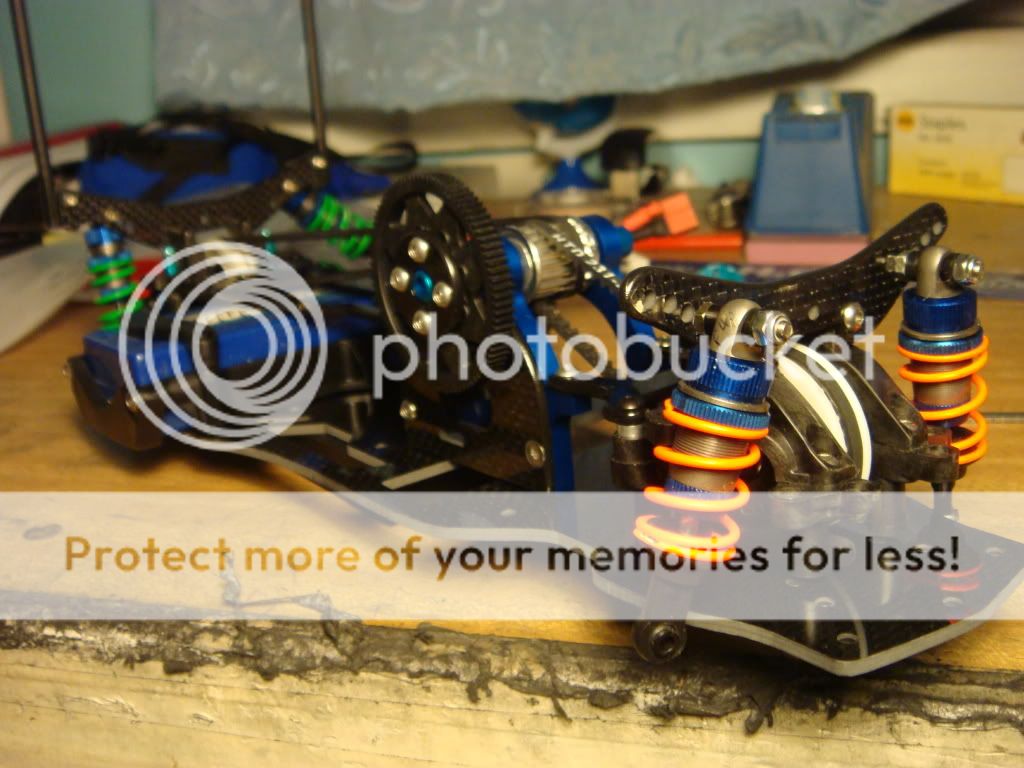

Yokomo BD
Make: Yokomo
Model: BD
Date: 18.5.11
Track surface: Smooth Cement
Tire: Drifter Street
Motor & ESC: Reedy Stockstar and Novak GT7
Front
Camber: 0 deg
Toe: 0 deg
Kick up: 1mm
Caster hubs: Removed
Ride height: 5mm
Springs: Yokomo Blue(Hard)
Bumper weight: IFS
Trailing Steering Block: Stock
Sway-Bar: None
Shock Oil: 30wt
Other: Caster mod (10+ deg)
Rear
Camber: 0 deg
Toe: +1 deg
Kick up: 0mm
Ride height: 5mm
Springs:  Yokomo White(Soft)
Sway-Bar:None
Shock Oil:30wt
Other:
Drive Train
Gearing:
Front: Yokomo 40t
Center: Front Colt 15t / Rear Yokomo 20t
Rear: Colt 32t
Spur: 78
Pinion: 23
Other:

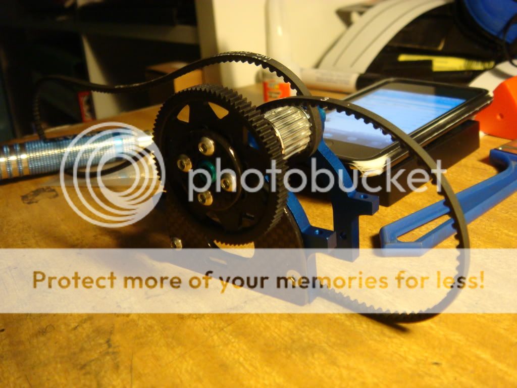

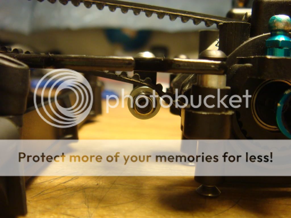

Belts are stock front and Schumacher 60t. A no tensioner setup would be a Cyclone front belt and a TRF416 rear belt.
Front 40x15, Rear 32x20. About 67% CS.

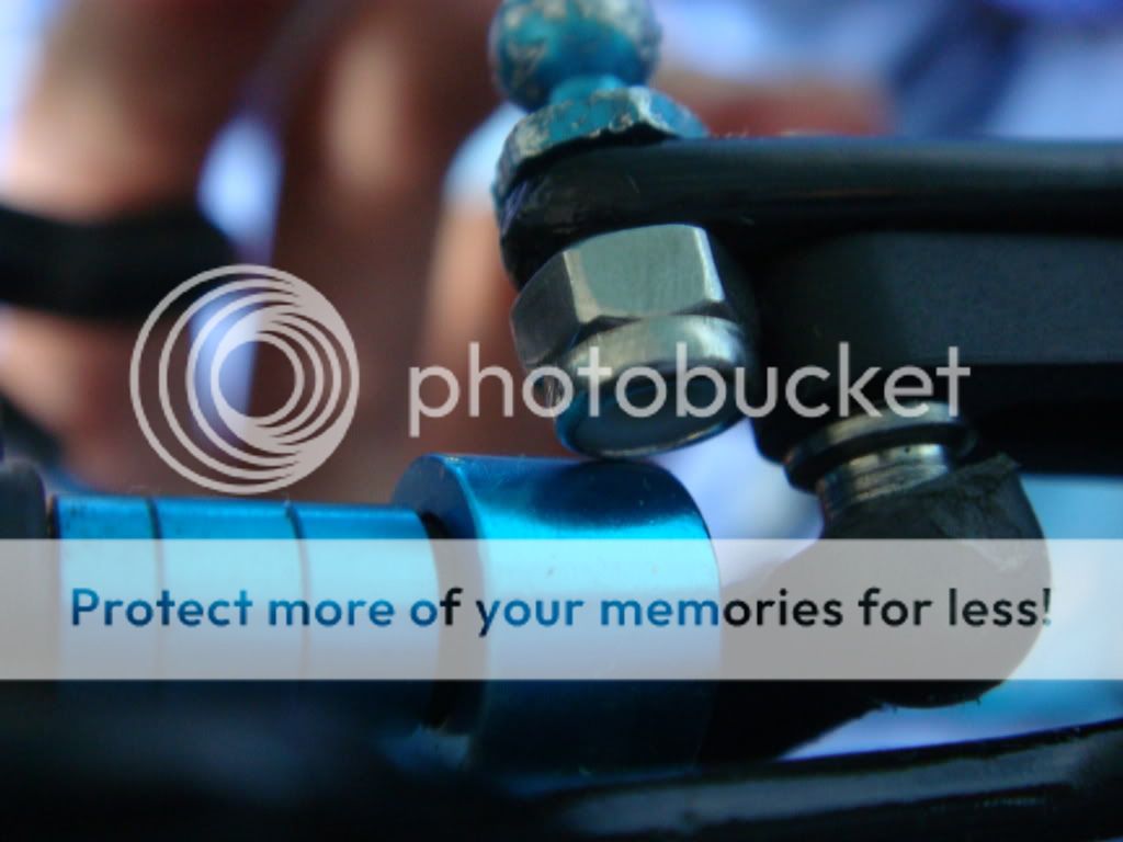

Castor and Camber at 13 deg on max lock
Outer Wheel
Inner Wheel

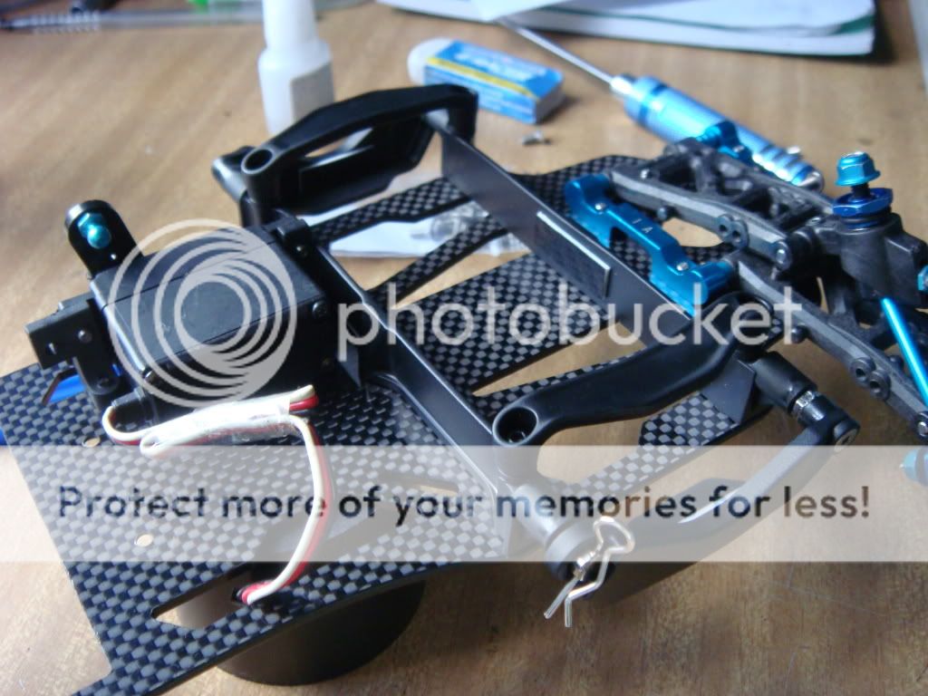

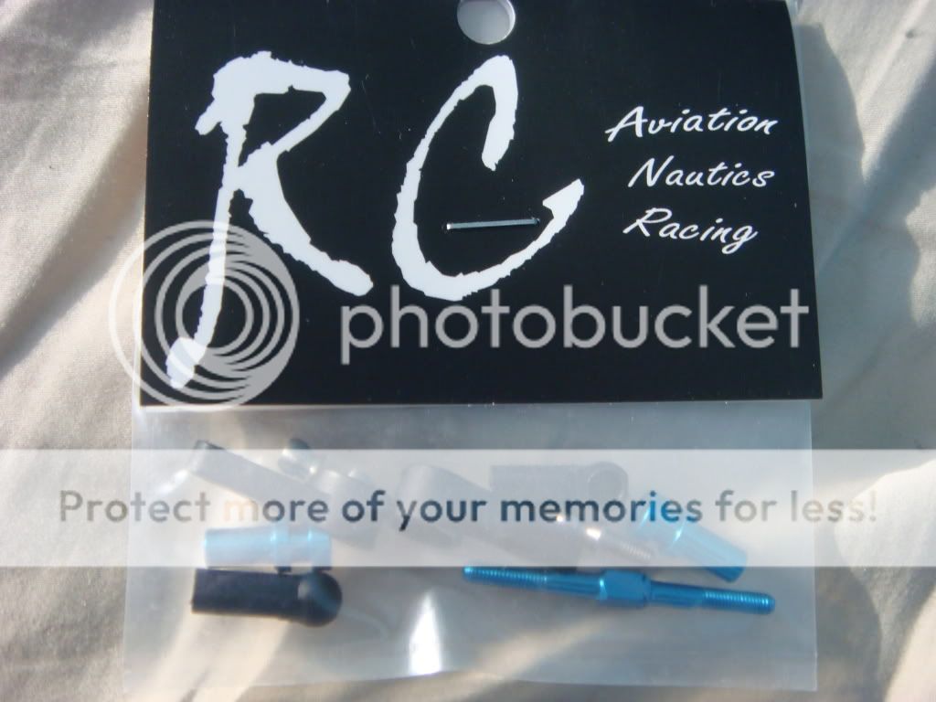

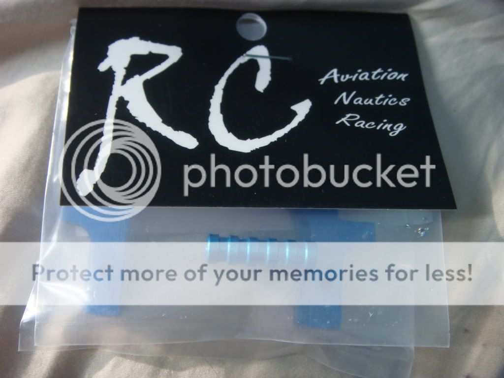

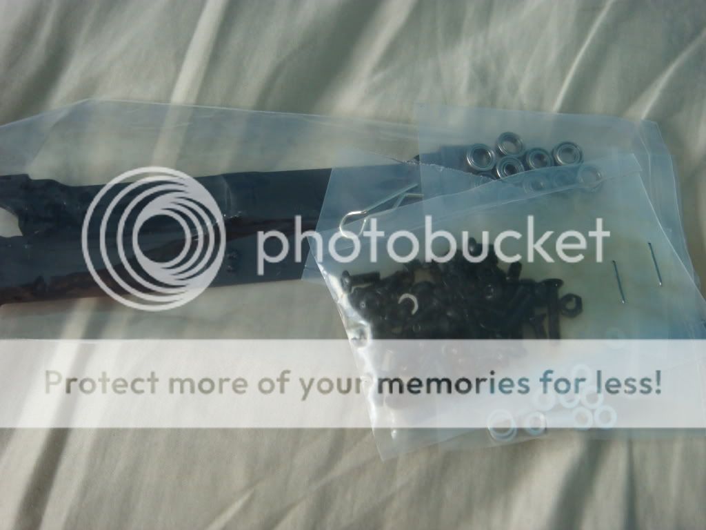

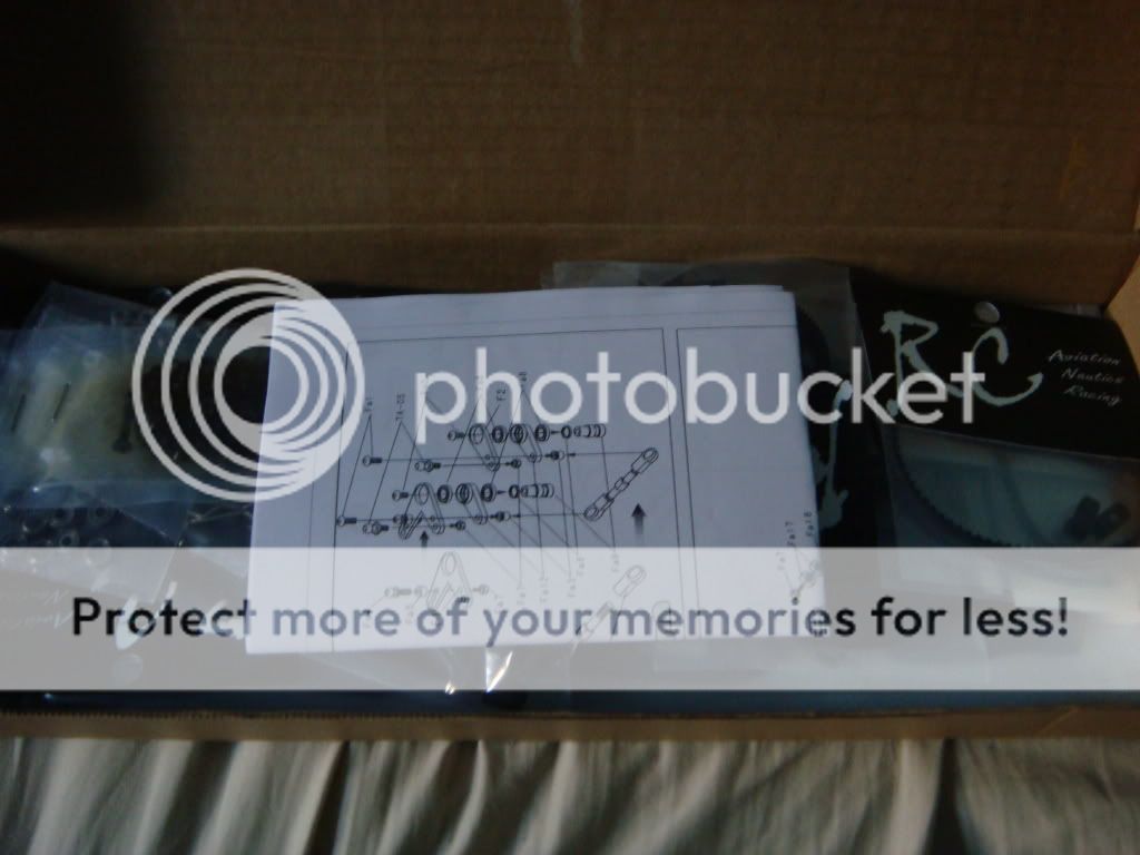

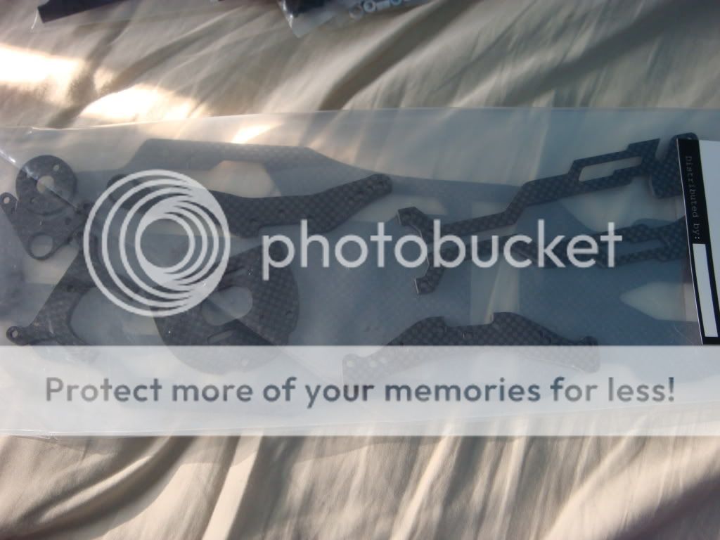

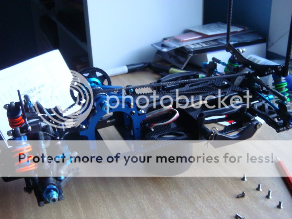

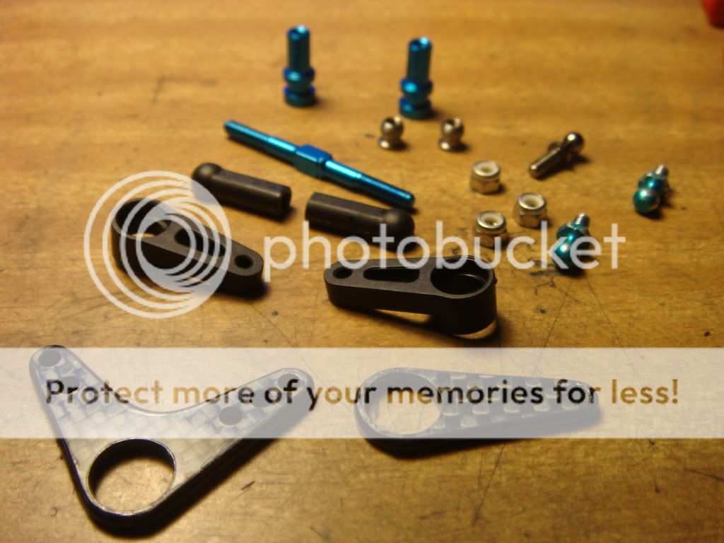

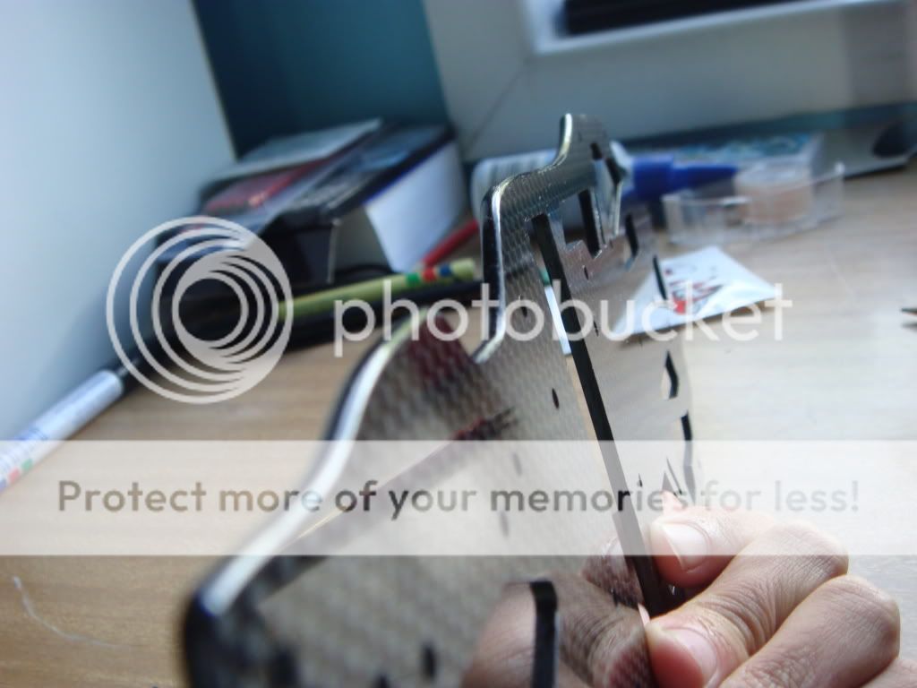

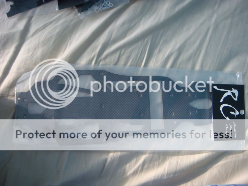

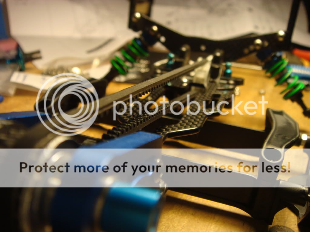

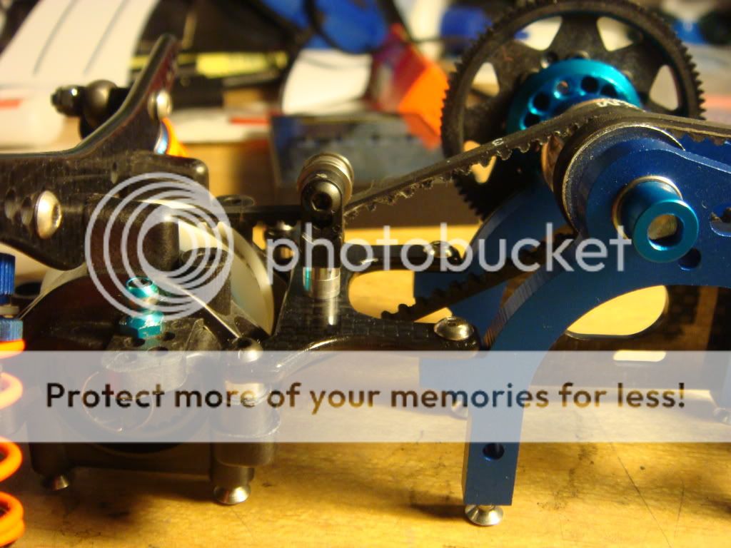

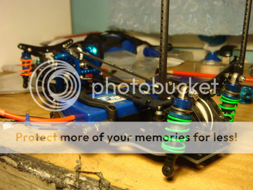

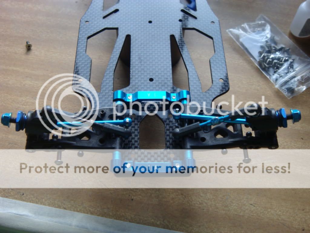

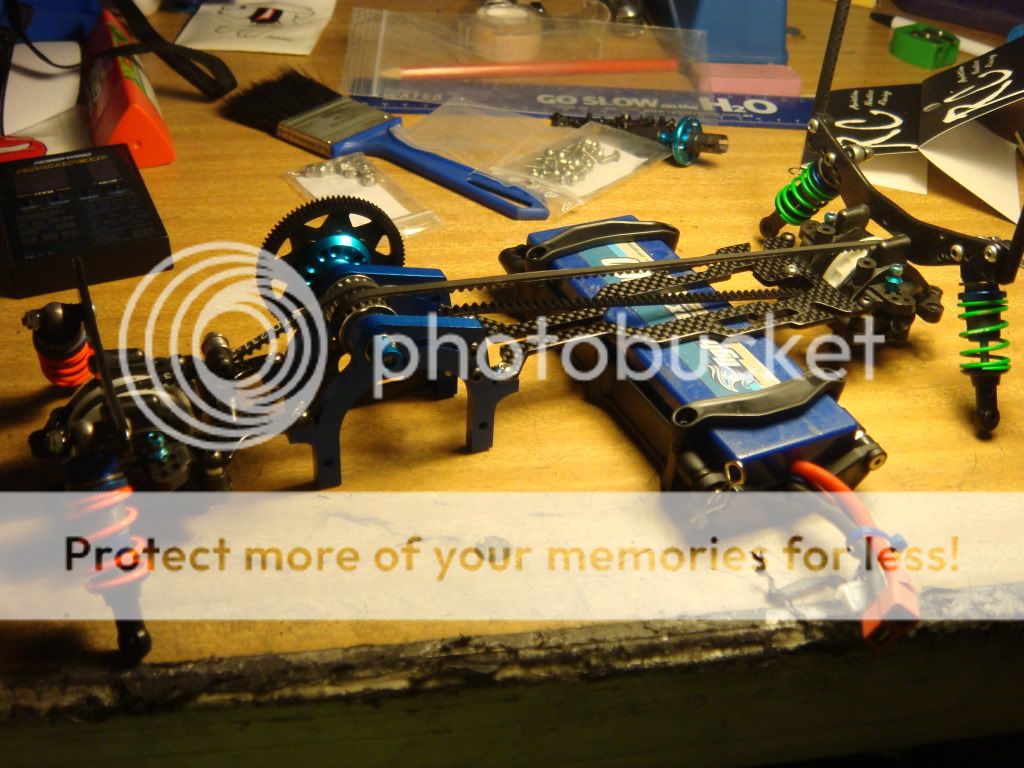

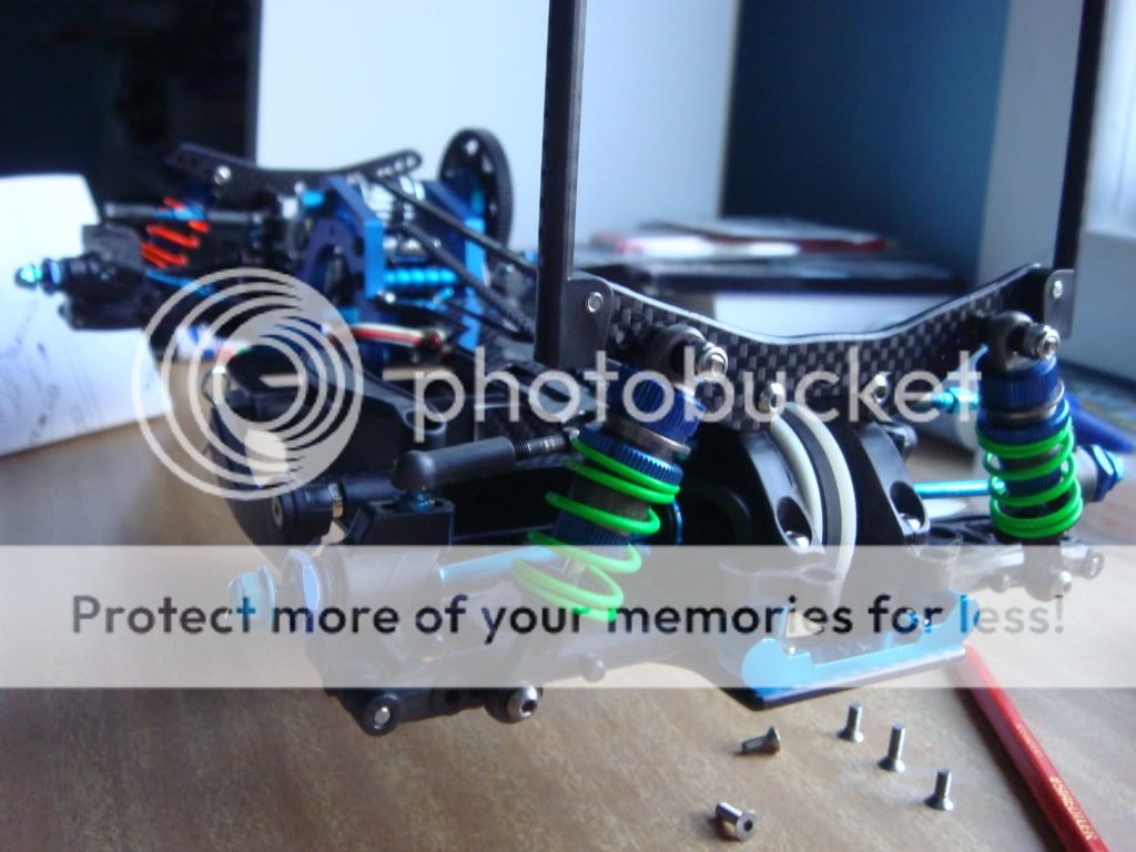

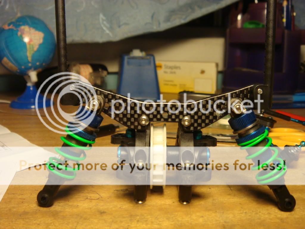

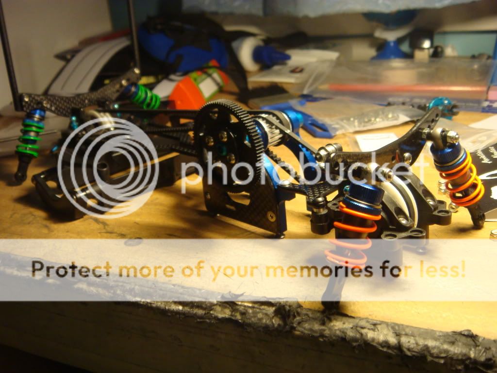

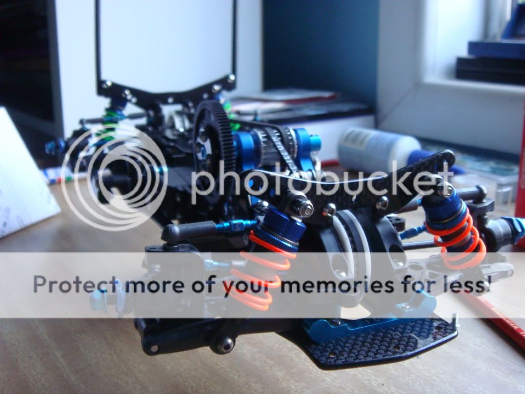

Tamiya TA-05 with a Fijon Conversion
From This...
To this...
Top View
Underside View

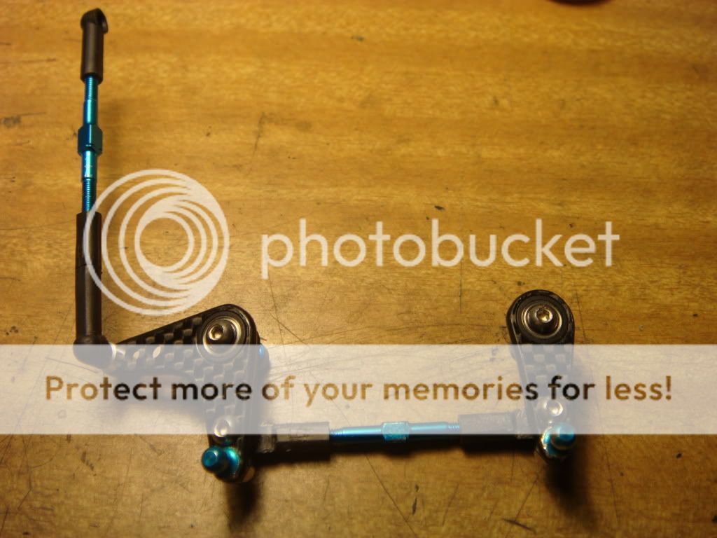

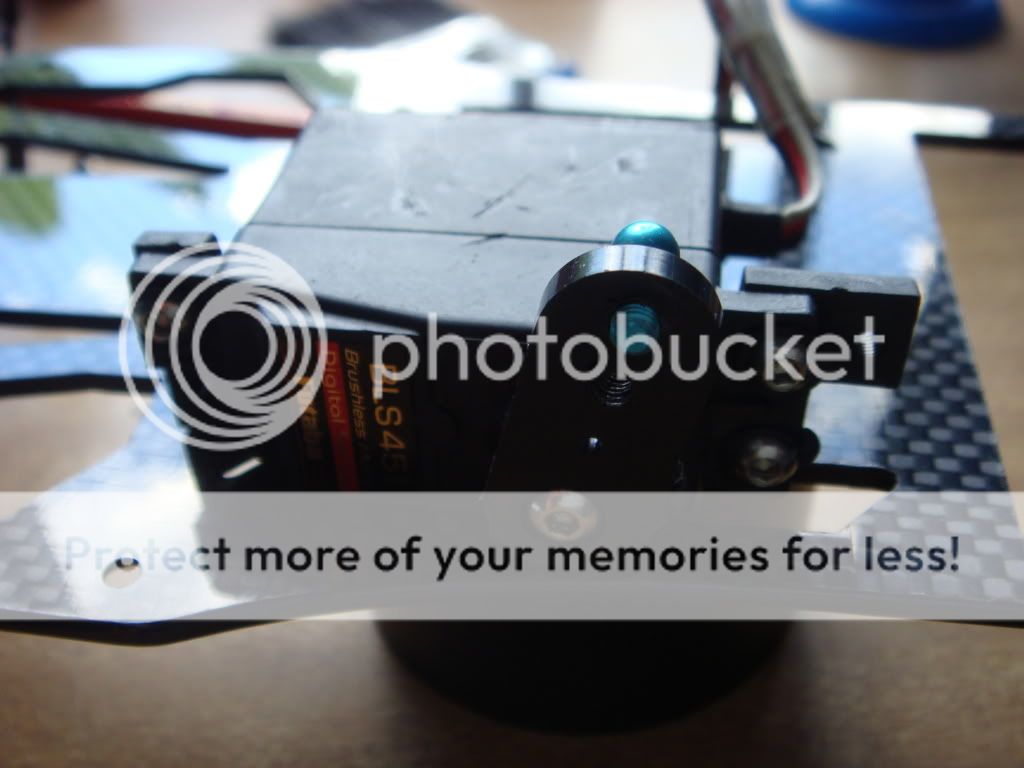

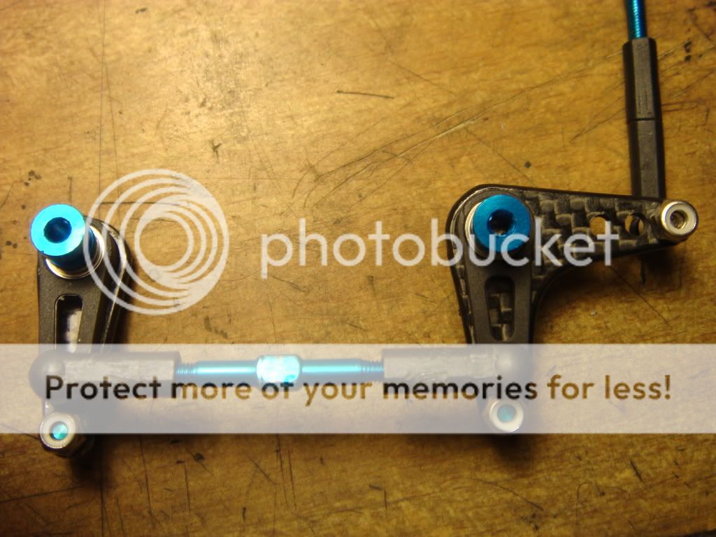

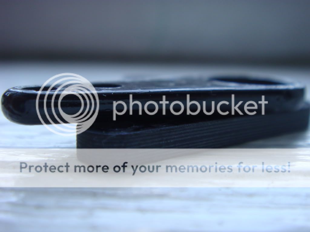

Steering
No Ackerman. I modded mine so theres no ackerman and I have max lock.
Build HERE!

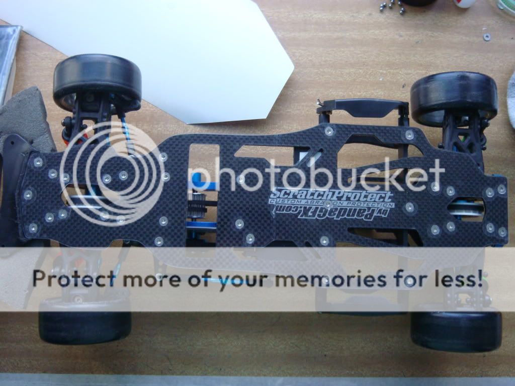

HPI Sprint 2
Chassis: HPI Sprint 2
Radio: Spektrum
Motor: Venom 8.5t Sensored
ESC: Venom 120A Sensored ESC
Servo: Spektrum Z270 Standard Race Servo
Full Silver Alloy Hop Ups
CS Ratio = 50%
Front 32t/10t and rear 15t/32t
FINISHED
Hardly any right lock
But max left lock. Gotta fix it somehow.
Front Mounted Servo, and crazy steering angle. Done by the owner.
